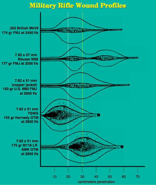

  I'm not a tanker and I dont pretend to teach then tank stuff -- but I do have a 10th of a 1/3rd of a schmick about shooting people.  NATO not just PEO Soldier is looking for a PDW -- since the US wants to go back to a .45ACP round PEO is freaking -- the Army killed their monolithic stupidity of OICW and the aborted XM-8 fiasco -- and basically PEO look like the turds they are.  The problem with these staff types in this case is they do not understand the enduser requirement.  What may work or sound nice on a drawing board needs to be immediately shelved if it does not work in combat -- failing that you are empowering the enemy.
Shooting people to neutralise a threat can be accomplished two ways either shutting down the CNS - or blood loss.  Since while neural motor strip shot look really cool but are real fricken hard in the real world -- we need a round that causes massive trauma - in a Hague Convention acceptable manner.
  M193 (55gr), M855/SS109/C77 (62gr) and Mk262 (77gr) do a pretty decent job due to they will yaw and fragment at certain impact velocities.
HOWEVER when they do no yaw - they too create small .224 holes -- which tend to look like an icepik.
The issue is to find the best round/platform for yoru requirements -- I tend to argue that the PDW is an answer in search of a problem.
While we may once again find an enemy that wears a lot of armour -- I still argue that the pistol is NOT the system to be using in that situation -- it should be the role of a primary weapon (and for the tanker out there -- that would be your primary personal weapon - not the weapon your driving around in)
I beleive that 99% of the CSS trades would be much better suited with a C8CQB -- and the same with many personnel in the Cbt Arms.  A 10-11.5" barrel with properly ammunition will be much more effective than most shooters can employ it.  I shot someone with one ~400m so no one come out and say it won't work or you cant hit that far.  The problem is 1) a system that refuses to learn 2) the fact that that system is too cool for non SOF types  ::).

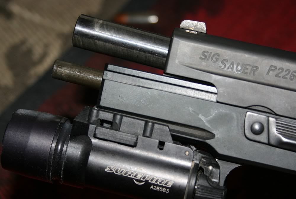

WRT the MP-5 -- while it is a good subgun.  Its still 9mm and I would not willingly use it in a long gun role -- heck while I use a 9mm pistol -- it is a 147gr JHP.  Ideally I will be able to find a .45 around here sometime (BigRed has a sweet 1911 he's running around with now).  I've been shot at a few time when the other guys with me had MP-5's -- fine and dandy if your in someone house -- but -- when the other guy brought a PKM or DsHk and is sitting at 700m -- not so fun.

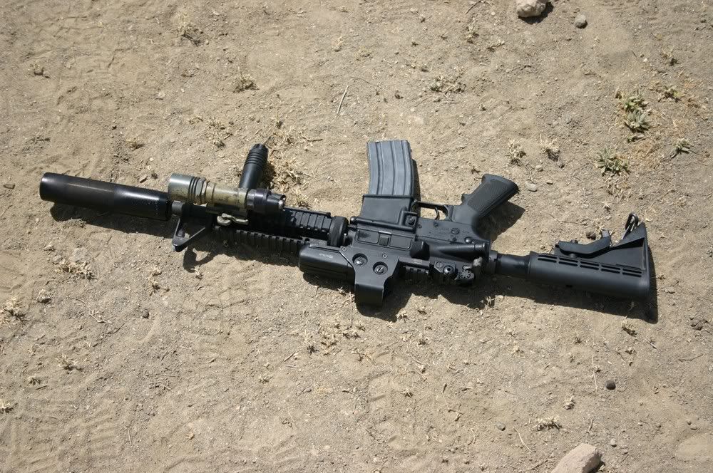

C8CQB w/ suppressor (well actually a US M4A1/Mk18 - but I was wearring a US flag at the time)
IMHO this setup would be a better (sans can) PDW for 99% of the people out there.

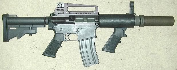

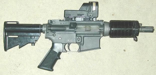

The earlier 4" M2Corp gun

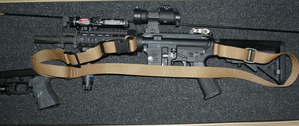

LCMM SA's home build (note the modified buttstock and cutdown rear buffertobe length)

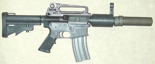

M2 Corp 6"

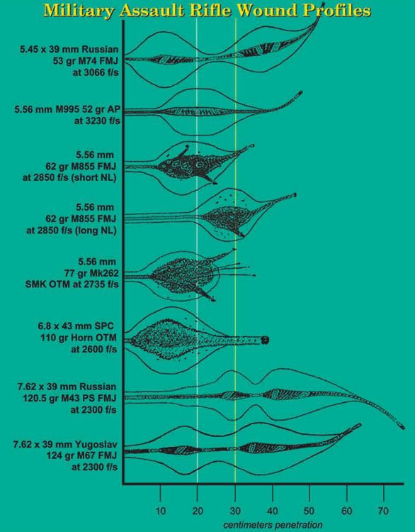

To get an effective system you need to balance it for the role you require.
A larger (and thus typically more effective terminally) payload will increase recoil energy -- and to tame that the mass of the weapon is increased.  Bullets cause damage by either crush or fragmentation (or a combination of both).  The large diamater of the projectile (all else being equal) will result in more tissue damage.
Keep in mind these PDW's fire a rifle type round (5.7 is a .224 calibre bullet) but at drastically reduced velocities - C77 (M855/SS109) needs a impact velocity of ~2500fps (and greater) to impact human tissue and yaw and fragment.  The longer Mk262 round is ~2200 fps impact velocity (and due to the greater mass causes wounds of a greater degree).  The SS190 round is of the same diameter - but shorter (less likley to yaw) and also leaves the weapon at a lower velocity.

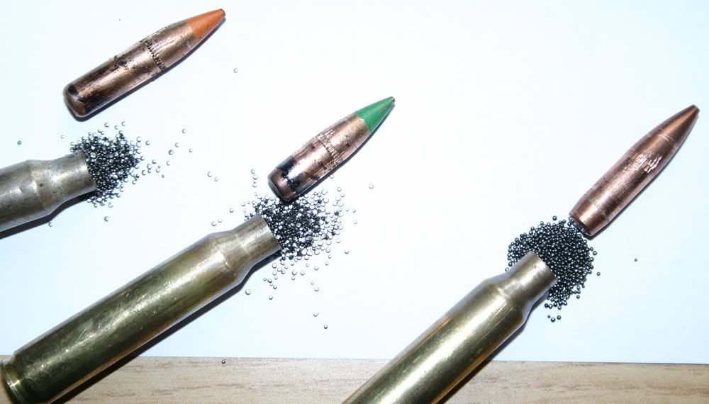

Does the Mk 262 use ball propellant like the C77/M855 or is it an extruded propellant?
KevinB
Army.ca Legend
8,204
1,140
I will check,
Edit MCG -- it is deffinately a ball propellant (my trusty CF SOG tool was used to remove a bullet head -- don't do that at home folk the CF frowns of tampering with ammo)
I will post some pics in a bit -- but I have to go earn my keep for the day.
I don't have any C77 here -- but I have M855 and M856 - so I will put a comparrision of the powers out too -- if I had my scale here I could give a readout -- my civilian Mk262Kev loading for service rifle use an extruded powder (Varget) --
Second point to note is BlackHills (and if the rumoured Canadian 77gr load is a copy it will too) uses a Flash suppressant in the powder as well so the Mk262 has much less muzzle flash at night than either M855 and C77.

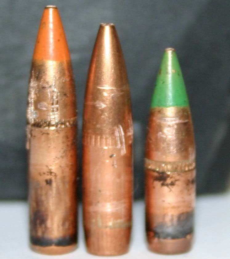

Okay back from my daily grind  ;D -- heading to the pool with BigRed - but first
Comparrisions for the M856 (L110/C78) Tracer, Mk262 Mod1 (77gr SMK with cannelure) and M855 (SS109/C77) round.
Edit -- my photobucket account is acting like a dog -- more pics to follow
KevinB
Army.ca Legend
8,204
1,140
Okay Photobucket was user (me) induced error
Mk262's ball propellant is much circular than the ones from M855 and M856 -- and Mk262 does not have the tar sealant on the bottom of the bullet.
Mk262 Mod1 uses a cannelure -- while the early and discontuned Mod0 did not have a cannelure (this allows the bullet to be properly crimped into the casing) -- As to the tar issue -- reports showed that the lack of tar increased accuracy and did not make the ammuntion any less weather resistant than ammuntion with the standard tar sealant.

C77 ball (97 head stamp) contains 24.9 grains of a dual gran ball powder, behind a 62 grain tar sealed bullet .907" in length in a boxer primed case.
