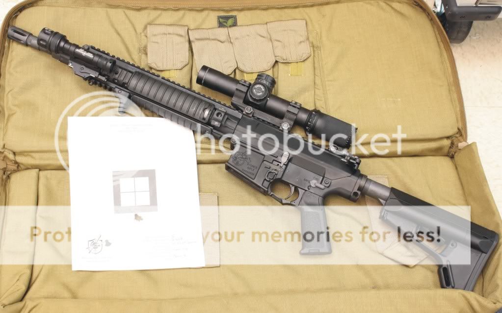

Near the first quarter of '09 we started work on a PIP of the 16" gun, as well as the 20” M110.
High-speed video, lots of rounds, more high-speed video, changes to the gas system, and more rounds and video, a lot more stuff and changes to the bolt carrier, the recoil system resulted in the SR-25 EM Carbine.
At the same time, the optical industry was busy working on a 1.1-8x scope to give the user the ability to take advantage of the added capabilities of the 7.62 round.
What we ended up with was in our opinion the finest 16" 7.62mm gas gun on the planet.
We shot several EM’s for over 1,000 rds fully suppressed with no additional lube, with no stoppages
We have done extensive lifecycle work on the guns, endurance testing etc.
We wanted to build the best gun we could, so if someone on a mountain top in Afghanistan or wherever else needed to have a gun that would go and go and go, it would.
  If he has to dump it in snow to cool it down, it would go and go and go.
With well over 50,000 rounds thru it, including a day where Mr. Knight and I stood in a puddle of muddy water splashing the gun to cool, we feel we are there.
Unlike our previous carbines, which we showed at SHOT (I have a pic somewhere of me holding the 14.5" gun at SHOT'04 when I was still in the Canadian Army) and never really publicly released for sale, we wanted a short 7.62 like this this gun to be our Flagship.
So its here, and available.
