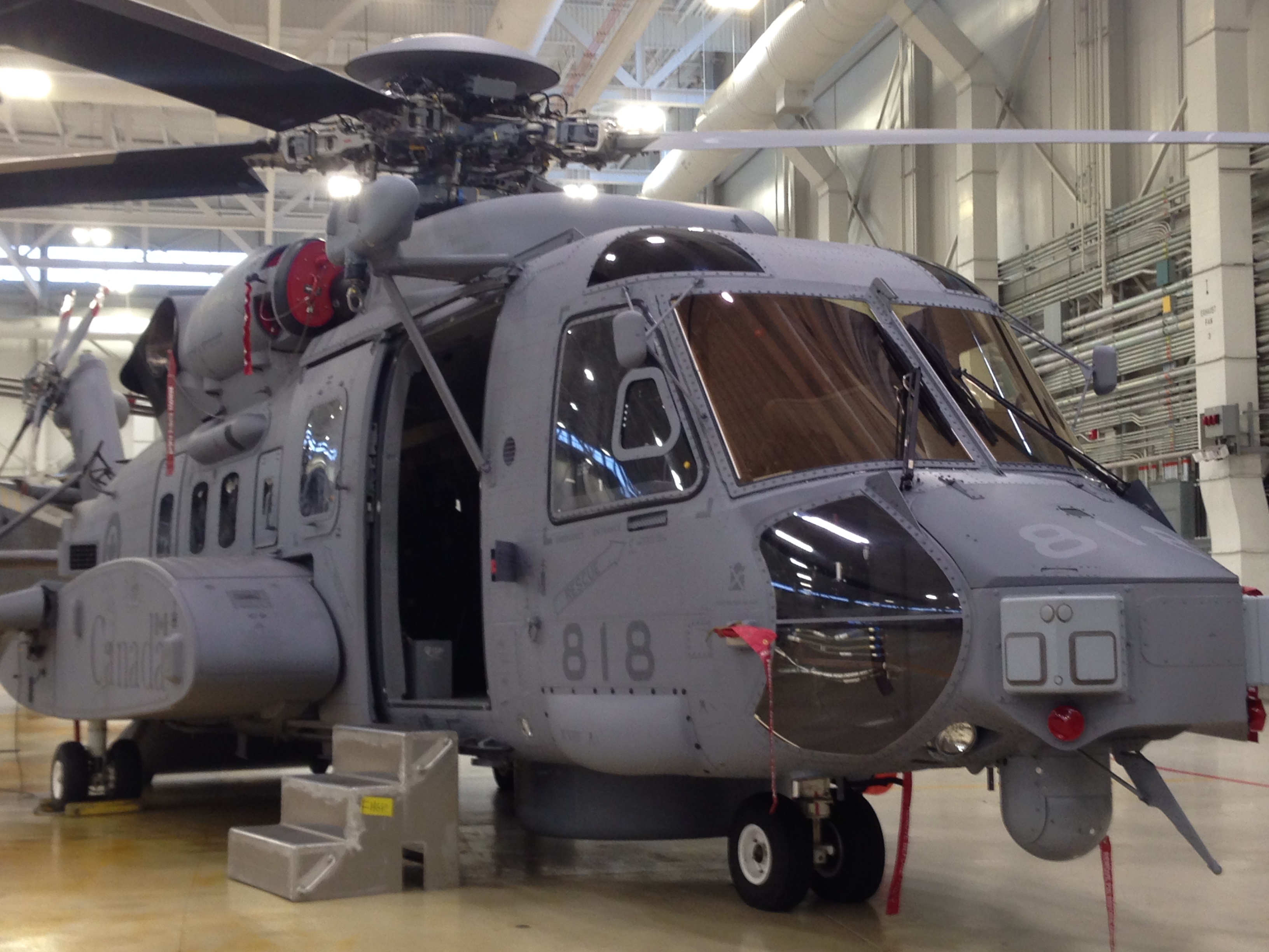

According to the CBC article:
Sikorsky is working with the RCAF to make repairs, according to the department. RCAF experts estimate that the repairs to some of the aircraft will be completed in "the next few days."
So, whatever the issue is, it's a relatively simple fix. Something they can do in "the next few days" isn't reengineering anything... they're just replacing a cracked part with a non-cracked part. Will the fix be permanent? Or will the new parts just have to be subsequently inspected at much lower intervals?
Colin Parkinson
Army.ca Legend
3,802
1,160
Likely it's a direct replacement with the same part, followed by a whole bunch of engineering to create a better part that does not create problems with other existing parts around it.

So one has been repaired:
"The location of the cracks on the tail structure are unique for each aircraft, although they are on the aircraft's frame and no cracking was found on the tail hinge or its components," the air force said in a news release on Wednesday.
