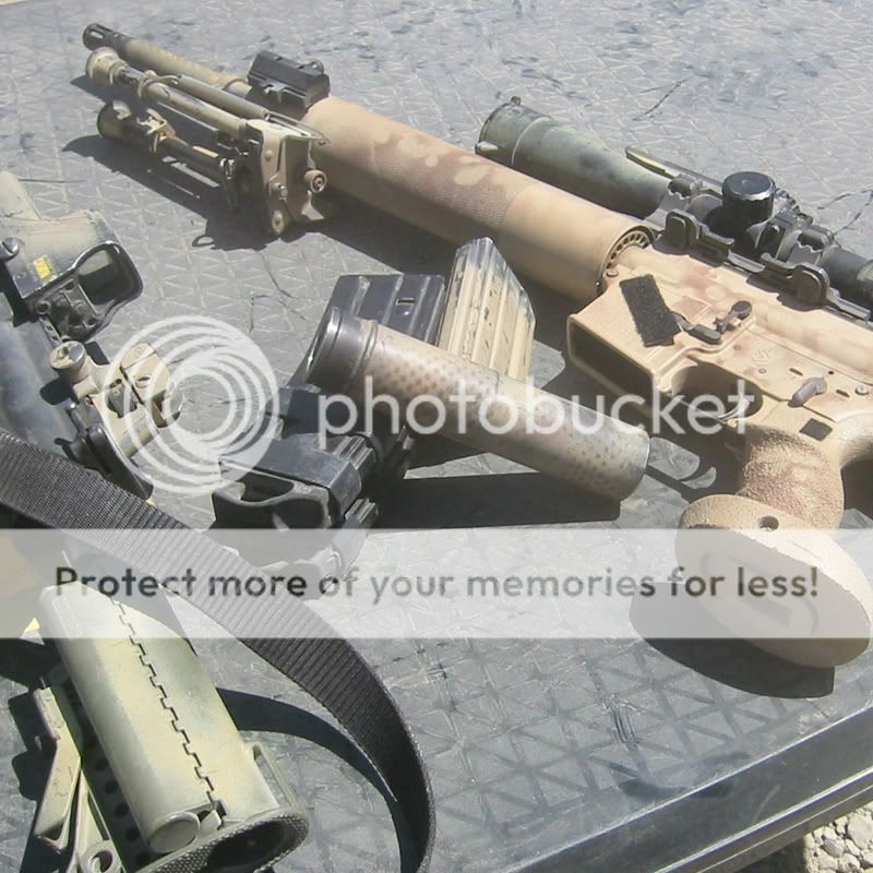

Greg,  For flip ups I have added KAC 300m, 600m and Troy sights to Diemaco uppers with no problems, and a LMT fixed rear
P.S. Hoddie over on CGN is current using a Troy on his...
I had to file the crossbolt on an ARMS #40 to get it to fit due to the CF tolerances being slimmer than the M1913 rails spec.
The CF upper has 14 slots while the US one has 13 -- so you can push the BIS up one notch toward the front (as opposed to the rear most) -- and the rear most the receiver is already starting to narrow for the charging handle.
Thanks alot Infidel, that's exactly what I was looking for, photo's with a Troy on a CF issue upper. I'm putting in my order at CQB services today, so thanks again for the assist!
                                                                    -Greg
a PHOTO is worth a thousand words.
Tell Joe is those LE where not so stupid they'd realise the reason why the BIS is falling off...
You can see on the pic of my SFW with the LMT fixed BIS on it that the extra notch on the rear of the receiver will not leave enough room on the aft end to properly mount a M1913 item.
The Diemaco upper has a weaver style rail instead of the more common (in most other militaries anyways) M1913 rail,I just took a file to my upper so the BUIS would fit,after all I'm not going to damage a perfectly good BUIS to fit on an out of spec rail. ;D. Why the uppers were not junked for an updated version with a proper rail is beyond me.
G -- you and I both know that dinosaurs rule the earth (or at least CF weapons issues...)
    Funny the C8SFW/FTHB barrels have a M4 profile -- but they used shitass C7A1 uppers so no M4 ramp in them...  GENIUS...NOT!)
